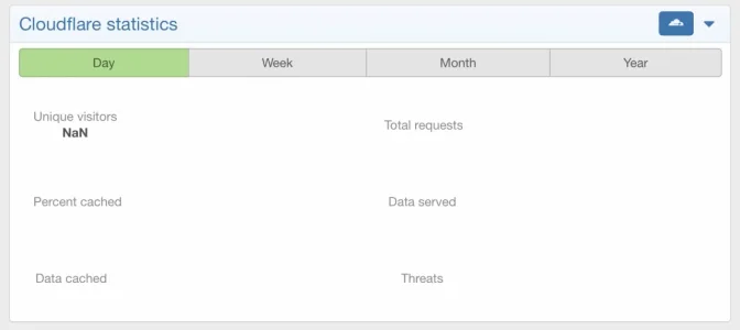

Upgraded to 1.6.0, but don't see Cloudflare analytics on admin index?
If you go to admin.php?template-modifications/&type=admin, do you see the template modification for index there? If so, what are the 3 numbers to the right of it?
Rechecked /admin.php and I cannot find it.
Maybe there is some token issue or some other error, which is not reported to server log?
The block is always there and then it populates the charts with an AJAX request. So even if there was an API permission issue you still would have the block with no charts. You are looking on the main admin page where it shows normal XenForo info/analytics like recent registrations?
Most likely missing permissions for your API token. Specifically, look at the Zone.Analytics: Read permissions. It might make sense to double check the permissions needed vs. what you have while you are at it (if one was missed, maybe something else was). You can see what's needed under XF Admin -> Options -> External service providers.
After visiting /admin.php?options/groups/serviceProviders/ and doing nothing I started to see the block in /admin.php. Strange.
Seeing cumulative stats for all subdomains, instead for forum subdomain only, but I guess there is nothing we can do about it?
No, sorry... the stats are for the zone (just like the settings you control for Cloudflare span the entire zone, not just an individual sub-domain).
Yep, missing Zone.Analytics.Read
