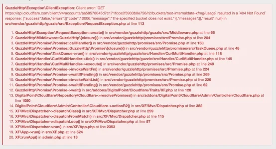

I made a mistake because of the name I set for the bucket so I logged in CF and removed the bucket directly from CF.
Now, when I enter the R2 options, I get this error:
Is there any way to let the addon know I already removed the bucket and it shouldn't look for it anymore? Otherwise I guess I'll have to remove the addon and reinstall it
You could recreate the bucket in Cloudflare, then disconnect it from XF settings and then delete it as a workaround for now.
I’m going to add a check for that in the next version.

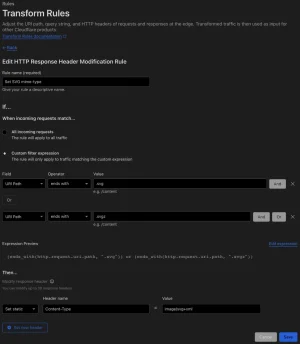

Not sure if anyone else has had issues with SVG images for their logo but I use a SVG image for my logo and it's referenced in styles/logo.svg for example. Today I uploaded the svg file over top of the existing one to see what would happen as the links are all getting referenced to my R2 data URL such as data.domain.com/assets/..../logo.svg. The forum did not render the SVG for some reason, it was a broken image link so I put it back. Not sure why this happened. FYI
SVG images are a bit of an edge case with R2. R2 attempts to determine what the mime type of the file is by analyzing the file. An SVG file is actually a XML text file when it comes down to it (like you can just open it in a text editor). So R2 sees it as such and sets the mime type to application/xml (rather than image/svg+xml). That's the underlying issue... R2 then tells the browser that it's an XML file, not an image (via the mime-type).
It's probably the "right" thing to do for R2 to classify it as application/xml, but not the convenient thing to do for site owners that want to deal with SVG. The good news is Cloudflare gives you a fairly easy way to override that if you want based on the URI (file extension) with their Transform Rules system. You could apply a transform rule to HTTP Response Headers like so:
Effectively overriding what the mime-type was set to based on the content itself.

It's something I've thought about, but it's not too high up on the priority list to be honest. It's really more of an edge case where people are uploading SVG images through the XF admin rather than putting them somewhere manually. Personally, I'd say putting style related images in the /styles/ folder is the better place for that stuff anyway.
There's a lot of powerful things you can do with Transform rules, but nothing that's really universal for all sites... so it's going to start adding confusion with a zillion options for people trying to handle everything that people might want to do with them.
...that being said, overriding the Content-Type for SVG/SVGZ images (which really are just XML files underneath it all) is a good use case for Transform Rules. :)
