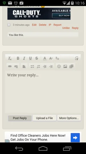

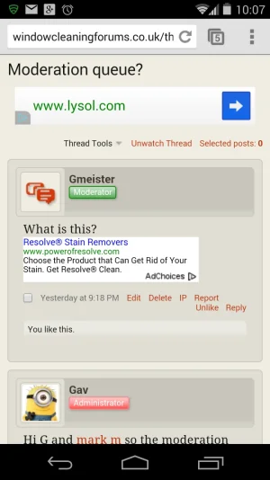

The right end of the as on mobile seems to be cut off as you can see compared to the footer as that I have inserted into the template. Why is this and also will this cause a problem with Google? I mean will this violate some term or something?
Yep exactly as given, I have even tried the code in the footer which displays fine. Could it be the theme I am using?
Ok so i seemed to have resolved it by adding another media line like this @media(min-width: 320px) { .in-post-ad { width: 234px; height: 60px; } } so now ads in the posts are smaller, i am presuming this is ok and fine with adsense as is the size of their half banner.
