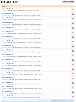

Im getting this error:
An exception occurred: Undefined offset: 0 in /var/www/vhosts/******.com/httpdocs/library/DescriptionContentRss/ViewPublic/Forum/View.php on line 48
An exception occurred: Undefined index: host in /var/www/vhosts/******.com/httpdocs/library/XenForo/Helper/String.php on line 280
Some forums work but some dont, not sure why??
