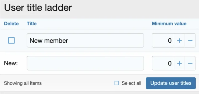

The correct solution is simple: You just need to add the previous value back in to the user title ladder screen:
In the field labelled "New" you just need to write the previous title back in and set the desired minimum value and click "Update user titles". If you put in exactly the same values as there were before you deleted them then it would apply instantly and automatically to all members.

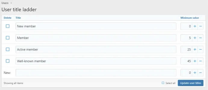

Can anyone tell me what the default Titles were?
My forum was setup a year ago by a friend
They were New Member, Member, Active Member and Well Known Member

The word Active seems to be your issue here so just delete or rename.
Some people like to use the ladder for their niche. For example, since yours is politics, a user with 10,000 posts might be Political Guru. Just a quick example, come up with your own.
