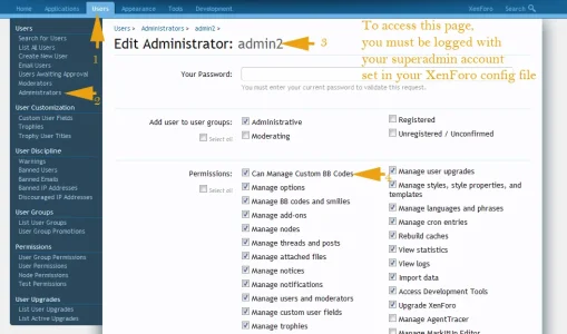

Please help! I think im going mad!
Just installed this mod however I cant seem to access it! No link visable and if I type BB Code Manager into the search bar and click on it, it comes back with
"You do not have permission to view this page or perform this action."
Ive looked through my permissions and cant seem to see a setting for BB Code Manager!
Any help really appreciated.
Make sure you have the correct administrator permissions.
Ive looked through my Administrator permissions and everything is ticked for allow.
Ive also tried uninstalling and reinstalling but its still not showing.
Any other ideas KK?
Can you screen cap your administrator permissions that should be the only way to get that error.
