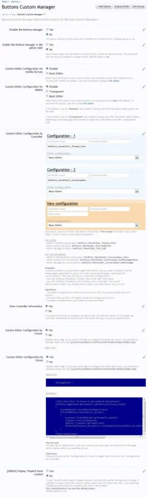

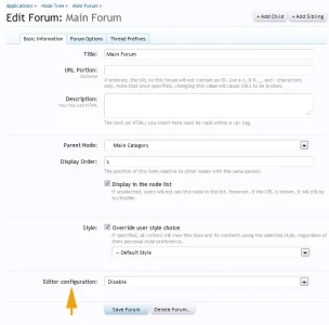

  • The "Editor Configuration Tool" by forums doesn't require any file edit anymore (see here to reverse the change you could have made)
  • After the Parser permissions (permissions by posters), here comes the View permissions (permissions by viewers)
    • A Bb Code Content Protection System has been included - you must activate it first and carefully read the disclaimer
  • You can choose to display or not the Bb Code inside the XenForo Bb Codes Help Page

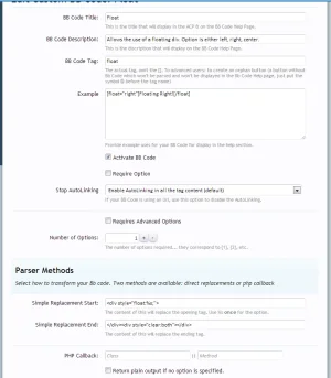

  • The layout of the Bb Code add/edit page has been modified. It has now tabs inside the Bb Code Manager.
    • The Button Manager still continue to use the classical view => tabs are not working with the overlay

  • The layout of the Bb Code add/edit page has been modified, new phrases, new categories, new explanations, etc.

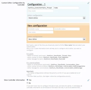

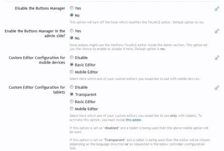

  • The options for the Bbcm (BbCodes Custom Manager) and the Bm (Button Manager) are now separated
  • The Bm can now create different layouts for the Editor
    The configuration of those layouts can be set by:
    1. Mobile Devices with an option for Tablets
    2. XenForo Controller Name, Controller Action, and/or View Name
      It will allow you to have for example a more basic editor for the quickreply (Threads) like on vBulletin 3.x
    3. Forums (you will need to manually edit 1 file)

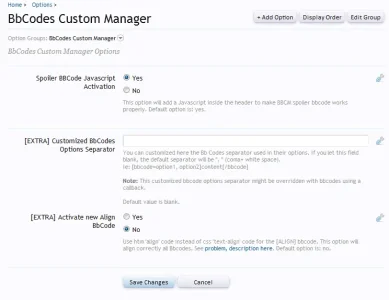

  • New option to disable the autolinking per Bb Code - For developers who don't use BBCM, the solution is here.
  • New option (XenForo Options=> BbCode Custom Manager=>Customized BbCodes Options Separator) to customize the separator to use in the Bb Codes options

Version 1.3.5.2 - Change Log:
-available here-
  • Modification of post #346 has been done since I've just helped a user who had a problem with this and this modification fixed the problem
  • Correct a small bug with the Bm
To upgrade:use the AutoInstaller addon or upload files/import xml
Before asking questions, please read at least what I've written in the options. Thanks.
Special thanks to lms & MOZ who helped me to fix bugs and give me some ideas & feedbacks
Edit: link to the third presentation picture with this time a normal quality
