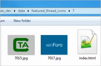

Each featured thread has its own icon - the icon name is directly related to the thread ID.
So although you can have a library to choose from, a new icon will still be generated for each featured thread.

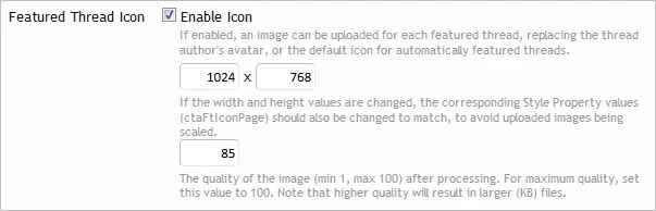

Someone just contacted me in private and asked whether the upload icon function could be used to add a different background to each block.
The answer is yes, very easily.

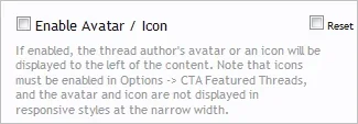

Simply uncheck this:
Then ensure the options are changed to allow for large "icons":

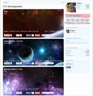

Then edit the template to add the icon to the container background:
HTML:
<div class="sectionMain ctaFtContainerPage node_{$featuredThread.node_id}" style="background: url('{xen:helper featuredthreadiconurl, $featuredThread}') no-repeat top"><span class="helper"></span>
The result is this:
Obviously further tweaks and settings may be required, but that took me about a minute.
