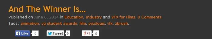

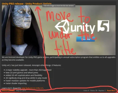

Request - I would like to customize featured thread page to have all links directly under the title with content to follow, example attachment thumbnail

You will need to edit the cta_featuredthreads_list_item and cta_featuredthreads_featured_list_item templates to achieve that.
The footer is contained within <xen:if hascontent="true">...</xen:if>.
You will need to move that entire block of code to just after the main div.

THANK YOU!
EDIT: Getting there slowly

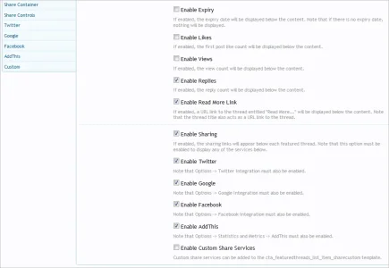

You can specify the duration for featuring threads in hours, days, weeks, months or indefinitely. The default setting is 2 weeks and this can be easily changed when featuring or updating a thread.
