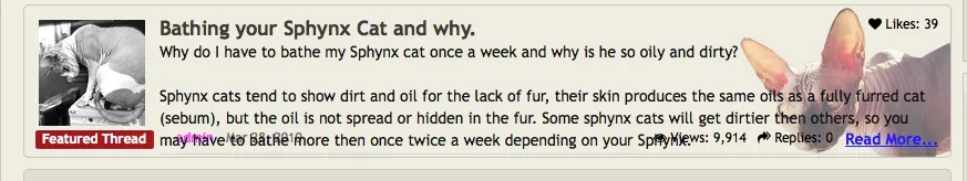

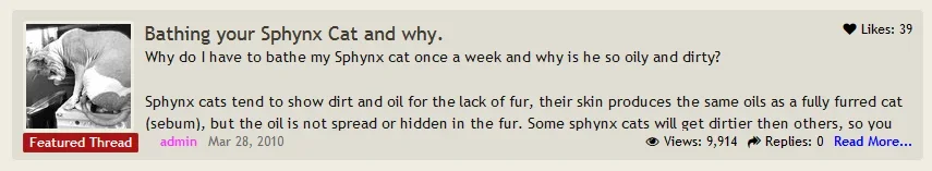

@Brogan - if I want the avatar image on the FT page the same size as Icon, (change setting as you suggested) do I need to rebuild a cache of some sort? avatar is still small but the spacing where it should resized looks correct. OR is it not possible to have the avatar on this page only 192x192.
