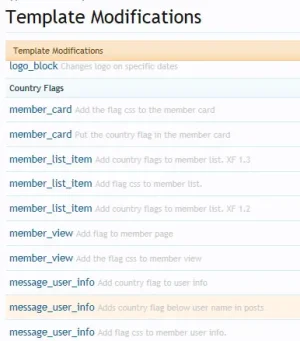

@Snog, how do I add a class to the <img> in the messageUserBlock please?
Can't find a template modification or a template.
I want to add a class and then add css to move the flag to a relative position so it overlays the avatar.
Thanks
Thanks
The template name is snog_countryflag and the css is snog_flags.css
There are also 3 template modifications to the message_user_info template..
