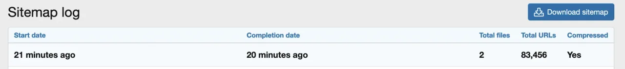

Hmm now I'm more confused. I don't think that's the issue but here's everything I can figure out:
We don't have full friendly URLs enabled.
I've manually rebuilt the sitemap a few times as a test.
The sitemap is generated and in internal_data there's a zip file containing the xml
/public_html/internal_data/sitemaps
-rw-rw-rw- 1 apache apache 1.4M Aug 14 00:31 sitemap-1628897450-1.xml.gz
-rw-rw-rw- 1 apache apache 561K Aug 14 00:31 sitemap-1628897450-2.xml.gz
The contents looks right from what I can tell.
The files aren't being created in the root directory (public_html) though.
