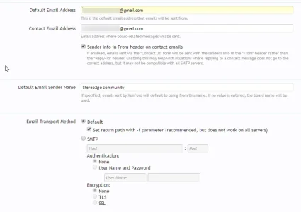

Pop has to be relating to bounced emails. As that's the only time it would check.
As your using Gmail you need to setup your SMTP server as you would in any mail client. Leaving it blank like that won't help.
Bounced emails isn't going to help. And won't work on a Gmail account.
Your host can't control Gmail (obviously). So they can't do anything to help.

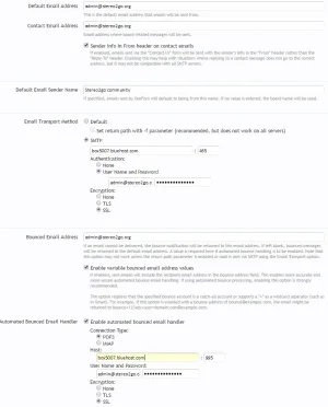

I put a gmail address by mistake for bouncing emails, now I'm using the very same addres from my domain.
However, many emails keep not sending, although some are bouncing.
My main problem now is sending, I'll leave bouncing for later.
