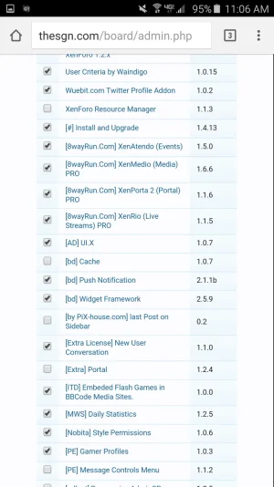

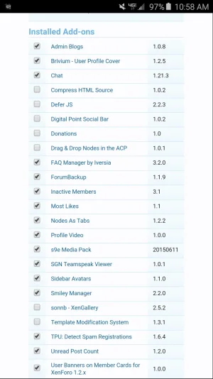

Here are all the add-ons I have installed.
The first troubleshooting step would be to reproduce the issue with add-ons disabled. If it doesn't happen, you'd generally need to re-enable them one by one to identify the cause.
