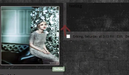

And my second question was, which part of the style properties do I have to edit in order to edit and make the space between the message and the avatar transparent? I attached an image of what I am speaking of

And my second question was, which part of the style properties do I have to edit in order to edit and make the space between the message and the avatar transparent? I attached an image of what I am speaking of.
Add this to EXTRA.css
.messageList .messageInfo.primaryContent
	background-color: transparent !important;
	background-image: none !important;
