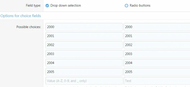

Im trying to unserialize a Media Gallery field_choices field (a BLOB) from the xf_mg_media_field table which contains a drop down selection with dates.

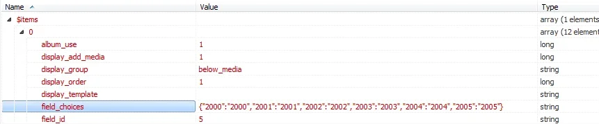

When I run it through the debugger, I can see the field choices
I have successfully unserialized other BLOBs using the same method so I dont understand why it does not work with this particular field.
