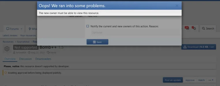

If resource is not approved by moderators, it can't be reassigned to another user, because "the new owner must be able to view this resource":

We have cases when one user posts a resource who developed by another user. We want give ability edit resource for real author before they will be approved. Suggested workflow is a ****.
Anyway, right now i found ability reassign resource to another user without approving: just reassign resource to self, add target user in "resource team" and reassign to he. In this case, it works.

A new, more beautiful, workaround: just use inline moderation. In inline mod, there are no one checks about user resource visibility.
Why this feature works too different from different interfaces? Can you explain? This is really "as designed"? If yes, when we can wait fix ability reassign resource without view permissions to another user in inline mod? :)
