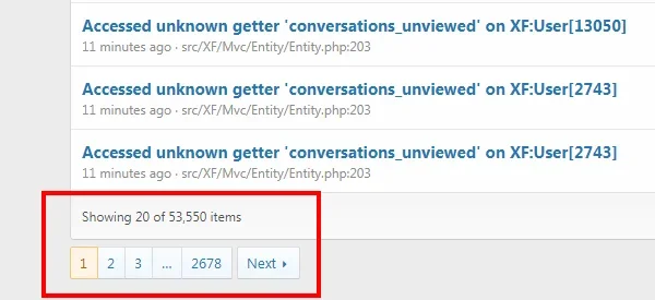

AH, good to know, thanks for this, Mike. Understanding why is helpful. So basically I renamed all tags "unread" to "unviewed" in Page_Container. But if I do a search for unread, I get a load of templates using the term. Only 4 of them are "red."
In EXTRA.LESS,
.is-unread .structItem-title {
    letter-spacing: 0.05em;
Sorry if this should be self-evident, I just don't want to break the site.
Regards,
Andre
Do NOT hard-code replace the word "unread" with "unviewed" in Page_Container. It resulted in 2678 pages of 53,550 server errors.
So, what did I miss?
My question is in response to Mike's explanation: "You should use "unviewed" as that's the correct value for the old behavior (and what we expect). The issue you were reporting initially -- alerts showing and then disappearing -- is specifically because you're referring to "unread" instead of "unviewed" as it's using inconsistent values and thus creating inconsistent behavior."
What do I do with this ^ information? I need to know exactly which template should be modified specifically, otherwise it clearly makes little sense to me (and I feel pretty stupid).
Thank you in advance,
Andre
