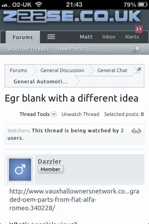

On my converted forum, the breadcrumbs are going onto multiple lines in responsive mode

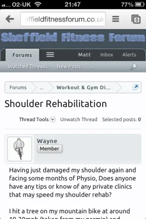

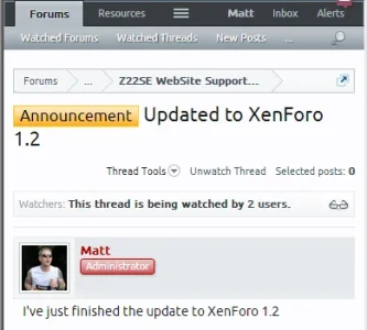

On a clean install, they are shrinking and fitting on a single row
Is there an option for this, or is something wrong after the conversion?
