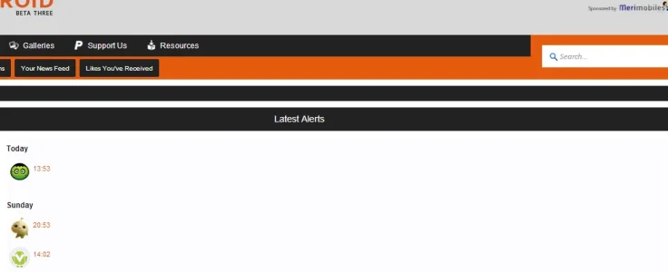

The built in Alerts function produces an error - an alert is made by there is no link, no text and the box isn't clickable. I've also tested the bd tag me addon and the same problem occurs.
Anyone have any ideas? It's a simple 1.15 to 1.2 upgrade and produced no errors, there were also no server errors logged.

The alerts that have no text.
What are they being generated by? Only by TagMe?
Or are they being generated by default functionality too such as quotes, replies and likes?

I've completely removed bd tag me now so only the default functionality is left. I've just tested using an admin account and standard account - Liking a post gives the correct result in the Alerts area, so I think it's just when using @.
So those blank ones are where someone has tagged you using the built in XF 1.2 functionality?
Can you check your Admin CP for this template: alert_post_tag
And this phrase: x_tagged_you_in_post_in_thread_y
Do they exist? Do they both have some sort of content in them?
alert_post_tag doesn't exist on the custom style or the default o_O
That appears to have fixed the issue. Thank you :) Can I ask why that wasn't done as part of the 1.2 upgrade process? I'm guessing it should have been but obviously something didn't complete, although no errors were produced.

It's the first time we've seen this issue. I even checked the old version of Tag Me in case that had a template of the same name (which would have been deleted when you uninstalled it) but Tag Me's template is called alert_post_tagged . Slightly different. Can't think what else would cause it though, unless that template did exist and was assigned to that add-on or if it was deleted manually after the upgrade was complete.
We'll have to mark it "unexplained" I think :)

This has also happened to me (now fixed with re-importing the Master Data) and it was the alert_post_tag that was missing .
Comparing my list of add-ons to those of the OP, the ones we have in common are (some with different version numbers):
******* - Change Threads/Posts Owner 1.0.4
Last Post Avatar by Waindigo 1.1.8b
Nodes As Tabs 1.2.2
[8wayRun.Com] XenPorta (Portal) 1.6.0
[bd] Tag Me 2.0.1
I think the blank alerts have only happened recently though, which I guess would rule out many of these as they have not been changed for a few weeks. The only exception to that is Nodes As Tabs which was updated at the end of September. Looking back in my emails, I received an email about a tag in a post just before updating Nodes As Tabs and I'm sure I'd have spotted a blank alert then.
Could Nodes As Tabs have anything to do with this? I'd have thought not, I don't think it has anything to do with the alert_post_tag template?
The only other possibility that I can think of (and would be more likely) is Tapatalk, which I uninstalled on 17th October. Now I know that it uses alerts and searching the install XML file I found
    <template title="alert_post_tag" version_id="8" version_string="1.1.4"><![CDATA[{xen:phrase x_taged_you_in_post_in_thread_y,
    'name={xen:helper username, $user, 'subject'}',
    'title=<a href="{xen:link posts, $content}" class="PopupItemLink">{xen:helper threadPrefix, $content}{$content.title}</a>'}]]></template>
  </templates>
(and yes, they have misspelled the phrase!)
Could it be uninstalling Tapatalk that has removed the alert_post_tag template? The above is the only reference I can find to the template in Tapatalk, I can't see a reference to removing a template unless I should be looking for something less obvious?
