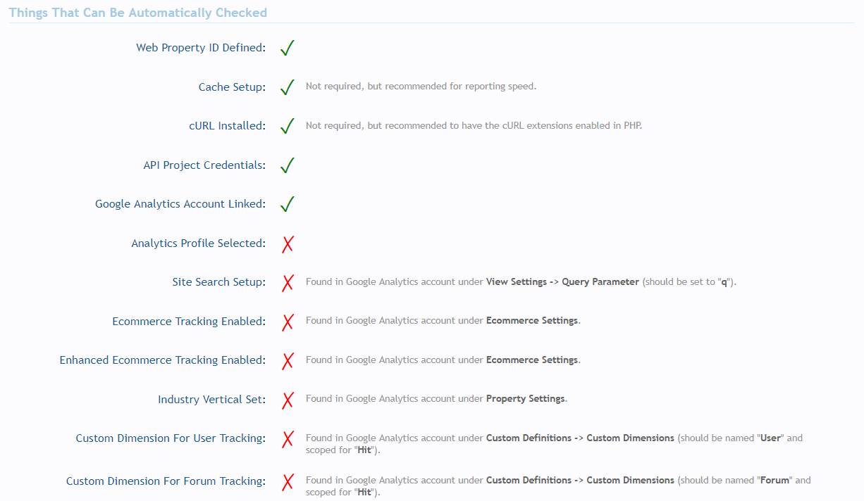

Edit: Have it working, it wasn't enabled here for anyone else https://console.developers.google.com/apis/api/analytics.googleapis.com

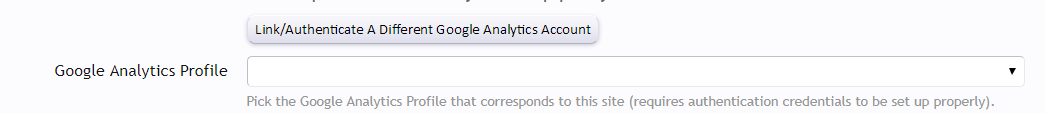

Hi @digitalpoint we are having a problem selecting the google analytics profile in the Statistics and Metrics settings
Clicking the drop down doesn't highlight anything after clicking 'Link/Authenticate A Different Account', The API credentials appear to be added correctly and working. Is there something that I could be doing wrong?

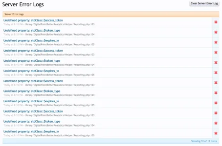

Have started getting some errors from this:
Error Info ErrorException: Undefined property: stdClass::$access_token - library/DigitalPointBetterAnalytics/Helper/Reporting.php:103
Generated By: Misty, Today at 8:10 PM
Stack Trace #0 /***/library/DigitalPointBetterAnalytics/Helper/Reporting.php(103): XenForo_Application::handlePhpError(8, 'Undefined prope...', '/home/ecf/publi...', 103, Array)
#1 /***/library/DigitalPointBetterAnalytics/Helper/Reporting.php(307): DigitalPointBetterAnalytics_Helper_Reporting::checkAccessToken()
#2 /***/library/DigitalPointBetterAnalytics/Model/Analytics.php(100): DigitalPointBetterAnalytics_Helper_Reporting->getData('7daysAgo', 'today', 'ga:transactionR...', 'ga:currencyCode', NULL, 'ga:dimension1==...', 'gaid::-10', 'HIGHER_PRECISIO...')
#3 /***/library/DigitalPointBetterAnalytics/ControllerPublic/Member.php(38): DigitalPointBetterAnalytics_Model_Analytics->getMemberReportData(322087)
#4 /***/library/XenForo/FrontController.php(351): DigitalPointBetterAnalytics_ControllerPublic_Member->actionAnalytics()
#5 /***/library/XenForo/FrontController.php(134): XenForo_FrontController->dispatch(Object(XenForo_RouteMatch))
#6 /***/index.php(13): XenForo_FrontController->run()
#7 {main}
