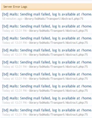

OK, thanks. But it is supposed to produce a Server Error Log entry though? I will get that for any hard bounce, or soft bounce?Bounced user is processed in cron so it may be delayed a bit.
Yes, it is supposed to do that. For both. And any other issues with sending emails (your account is banned for example).OK, thanks. But it is supposed to produce a Server Error Log entry though? I will get that for any hard bounce, or soft bounce?
So the cron job requires these server error log bounces to action and set the user state? ie. if i delete the bounces from the server error log then the cron job won't work correctly?Yes, it is supposed to do that. For both. And any other issues with sending emails (your account is banned for example).
Maybe I'll add option for that.
You can empty server log.So the cron job requires these server error log bounces to action and set the user state? ie. if i delete the bounces from the server error log then the cron job won't work correctly?
I realy on the server error log to let me of issues that need my attention, and I guess having bounces in there that don't need attention just makes it confusing.
Thanks.
