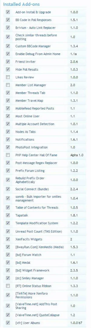

Hi xfrocks, I'm using your add-on version 1.1 - my xenforo version is 1.1.4
No that's alright :P
Do you mean though that in your new version of the add-on , this doesn't happen ?
No that's alright :p
Well, I have just installed old version for XenForo 1.1.5 and it works allright. Can you give me list of installed add-on?
