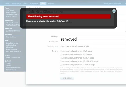

But I cannot create a client...it seems. See enclosed error.
I set the permissions for BOTH me personally (my username) and for Administrative, which I obviously am if I am in the ACP.

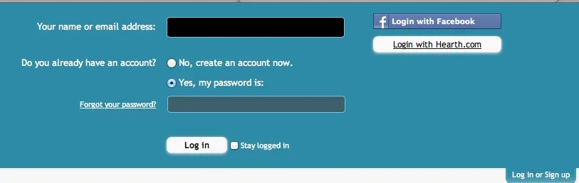

Given those settings, when I go to the SLAVE site in a new browser (not logged in anywhere), I see a screen like this:
But hitting the Login with Hearth.com button brings me to an error page at hearth.com.....

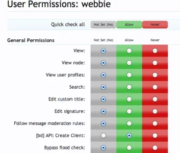

3. Set permissions in the ACP so your username is allowed to create API clients - see enclosed

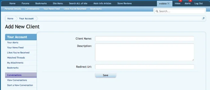

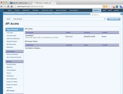

4. Create a client - this is a little tricky because it seems as if you should do so in the ACP, but that doesn't seem to work! Xfrocks said to create it by going to this URL:
http://www.mastersite.com/xenforo/account/api - see thumbnail - notice the API Access item in the left menu and the API screen being shown with "create new client".
5. The client is easy enough to create - just give it a name and description (anything), but the redirect URI should be back to the OTHER (slave) site XF installations - that is slavesite.com/xenforo or whatever your URL is. The API will automatically create your secret keys.

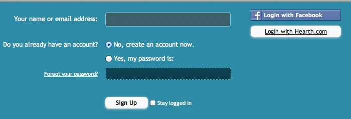

That's it! Now, when a new user enters the login screen at slavesite.com/xenforo/login (or any of the Ajax variations), they will see a button or link which says "login with mastersite.com" - and by following that, they should be able to login to the slave site after approving the remote login.
Note - as Xfrocks has mentioned, this does not copy a password over to the new site - it is like facebook in that regards. But it does copy the email and if the user ever wants a full login (not using this add-on) to the new slavesite.com, they can get themselves mailed a password...and reset it from there.
