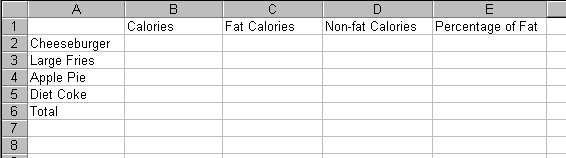

This'd be something for Brogan? I'm assuming you are using is code?The reason I installed this add-on was to help a user who wants to post some table data. I was building a sample table to show as an example, but I get an extra blank row in between each row. I have tried various manipulation of the [tr][/tr] and the results seem odd. On every other row I can remove the [tr][/tr] and the extra blank row will disappear. After that, the data begins appearing on the same row, which is the behavior I would expect.
Calories [Fat Calories] Non-fat Calories] [Percentage of Fat] Cheeseburger Large Fries Apple Pie Diet Coke Total
I am basically trying to manually re-create this sample table I located:
