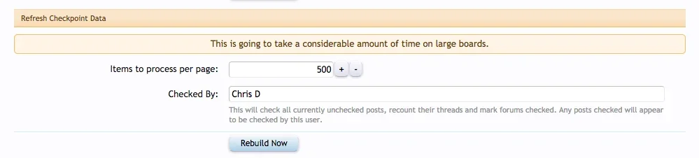

Assuming all posts are marked as uncheck on install - I have 4+ million posts and no interest in retroactively checking existing posts, so is there a way to mark everything as checked after installing so that we only have to check new posts from that point on?
No, there's no options now. I should probably re-implement them at some point (or at least I will if people need them).
Maybe remove the screenshot from the overview? I just uninstalled and reinstalled because I thought it had screwed-up ... :LOL:
