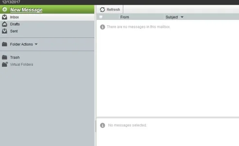

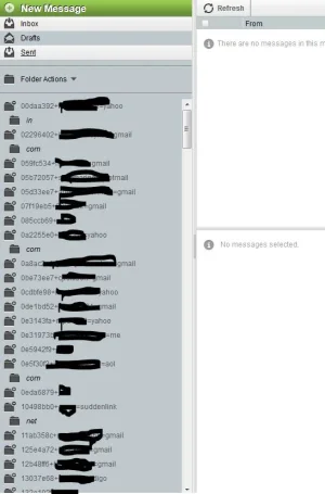

@Mike and anyone else for that matter, a few months ago when I moved servers, all of the sudden all of the emails that were bouncing back for anything at all (even out of office auto-replies) have been going to what seemed like random sub-folders, and I would never see them in my main "bounce" email folder
I see this
But clicking here
then i see this
there's all my bounces.
You can't, that's just an open discussion, it wasn't implemented. What you've posted above in screenshots is exactly how it's NOT working in cPanel, as Mike predicted.
