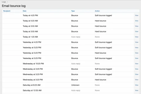

To answer the question about whether the feature works, including on our own forums, absolutely it does. I'm not sure what leads you to believe most customers don't have it working. Customers who want to use it do so without issue for the most part. There are occasionally gotchas with some emails not being detected though these are usually modified externally (spamassassin is fairly common in terms of adding additional headers which may not meet the standards to allow them to be parsed). But even those emails do not disrupt the overall ability for the system to work, it's just an occasional bounce may not get processed.
We've not had any similar reports of issues and, as I say, ours is functioning fine:
