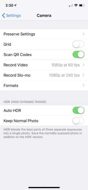

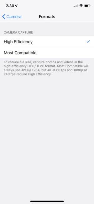

No I wouldn't have thought so. My settings are the same and those settings are explicitly for the camera - they shouldn't apply to screen recordings.
