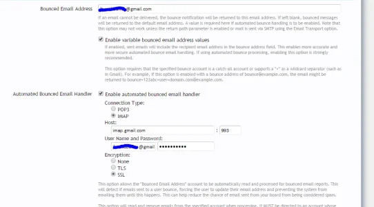

Bounce-handling with Amazon SES works just fine.
Here's what you have to do:
In Options -> E-Mail Options:
1. Enable variable bounced email address values
2. Enable automated bounced email handler
Setup a mailbox where you before pointed the "Bounced Email Address" to and put in the details.

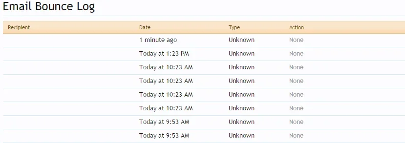

Is Xenforo bounce handling working for anyone using Amazon SES?
Options -> E-Mail Options is setup correctly, and I have Amazon SES setup correctly to send bounce notifications to my Bounced Email Address.
The Email Bounce Log ( /admin.php?logs/email-bounces ) shows emails received by XF from my Bounced Email Address, but the 'Action' within the Email Bounce Log is all 'none'.
Thus, Amazon SES bounce notifications being sent to my bounce email address. XF correctly retrieving the new emails from the bounce email address account. But xf is not able to process them into meaningful actions (eg. set the User State to Email Invalid)

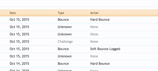

What's the body of your bounces from SES look like? I get;
{"notificationType":"Bounce","bounce":{"bounceSubType":"General","bounceType":"Permanent","reportingMTA":"dsn; a27-38.smtp-out.us-west-2.amazonses.com","bouncedRecipients":[{"action":"failed","emailAddress":"<redacted>","status":"5.4.4","diagnosticCode":"smtp; 550 5.4.4 Invalid domain"}],"timestamp":"2015-10-14T07:49:59.251Z","feedbackId":"000001506553c0de-8ca839e6-<redacted>-4506-a204-3b6451a553df-000000"},"mail":{"timestamp":"2015-10-14T07:49:58.000Z","sourceArn":"arn:aws:ses:us-west-2:403<redacted>681:identity/<redacted>","source":"bounces+9762fff1+<redacted>=<redacted>","messageId":"00000150<redacted>-91bbec90-48a6-4347-8c73-2f4f38956ae3-000000","destination":["<redacted>"],"sendingAccountId":"40379<redacted>81"}}
and XF Bounce Log says Type: Unknown and Action: none
