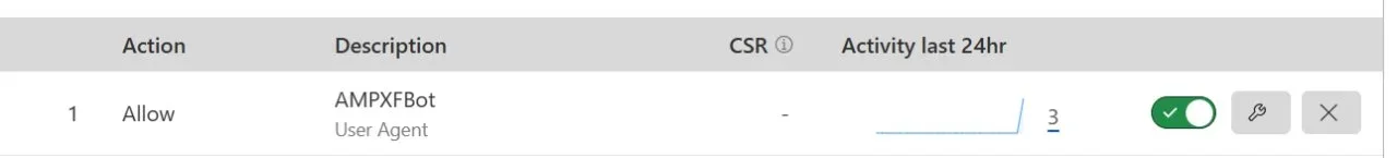

It seems the Ampbot is being challenged by Cloudflare when trying to reach your site, please check out https://ampxf.com/faq/how-to-whitelist-the-ampxfbot-in-cloudflare.13 for instructions on how it can be unblockedI have had to restart my Ampbot twice now in the last two days, it is sticking on pause only after latest update. Anyone else have this problem?
So, I added it and I can see it hitting it (from Germany), but i just went in again and it was paused. I logged into the server and I can see it hitting the server as well. It only started after the latest update. I have had no rules in place before and it used to work just fine. Any ideas?It seems the Ampbot is being challenged by Cloudflare when trying to reach your site, please check out https://ampxf.com/faq/how-to-whitelist-the-ampxfbot-in-cloudflare.13 for instructions on how it can be unblocked![]()

Hard to say why cloudflare would block it now, but maybe there has been increased bot activity lately and they increased likelyhood of doing challenge? Anyway if you now added the rule it should be allowed in the futureSo, I added it and I can see it hitting it (from Germany), but i just went in again and it was paused. I logged into the server and I can see it hitting the server as well. It only started after the latest update. I have had no rules in place before and it used to work just fine. Any ideas?

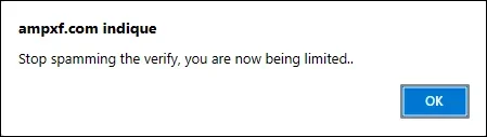

I can trigger a bulk verify for your site
Thank YouI can trigger a bulk verify for your site![]()
