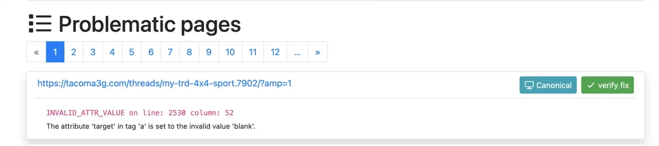

I didn't get to read this whole thread. Is there an FAQ page about what we do for the problem pages. I have about 3,000+ so far:
You have to go to the non-amp version and edited the posts to make them proper, then click on the verify fix button, if it goes away then it’s proper, if it doesn’t re-check them.
What needs to be edited to make them proper? Also, I would need to do that over 3,000 times to fix it?

Idk, my site doesn't have any ads. I realized I could open a ticket on the AMP site. We'll see.

Thank you. So with this add-on I can no longer have those links open in a new tab for the user?
you can.
I found the problem. target="_blank" is ok. But you have target="blank" (no underscore) in the footer. And that's not ok in AMP.
Just add underscore. "_blank" instead of "blank".

I sent them an email yesterday with some instructions about the footer containing the broken target value.
Simplest workaround for now would be to disable the footer, but the "correct fix" is to fix that broken markup in the footer :)

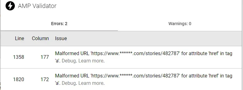

@mazzly Not Comaptibility with Xenforo Core Censoring Option because URL text are censorship.
Ahh so now I know why some forums have had those weird *** urls in their pages :D
I thought it was some legacy links from old/migrates forums etc.. But it is actually an XF feature.
Anyway: If a phrase/url has been censored in XF, then this AMP will help you find posts where you can remove those links ;)
I think that's a core xf bug, honestly. It's broken in standard markup just as it is in amp.
Yeah I think they just do a very basic "search and replace" and that one will match things inside url as well.
But on the other hand if a url contains some "bad phrase" it is probably good that the link also becomes invalid, and the AMPBot will help you find posts to be removed/edited :)
