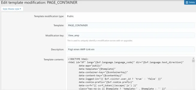

I get redirected to the normal version of the thread. I couldn't find if there was a permission or anything.add ?amp=1 in the URL when you are visiting a thread.. For best experience do it with a Mobile viewport/size![]()
hmm that doesn't sound right.. I checked your site and it seems the ServiceWorker is doing some redirecting there.. Do you have some customized Service Worker?I get redirected to the normal version of the thread. I couldn't find if there was a permission or anything.
No idea. Maybe it's some plugin/theme messing with it. I'll check it out and get back to you.hmm that doesn't sound right.. I checked your site and it seems the ServiceWorker is doing some redirecting there.. Do you have some customized Service Worker?![]()
ThanksNo idea. Maybe is some plugin/theme messing with it. I'll check it out and get back to you.
I got it to work! thank you very much.Thanks![]()

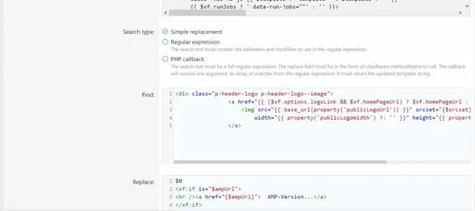

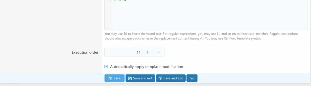

$0
<xf:if is="$ampUrl">
<br /><a href="{$ampUrl}"> AMP-Version...</a>
</xf:if>

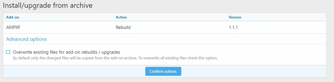

Now fixed... Clearly time for me to go away from the computer for the eveningWrong package it seems for 1.1.2?
addon.json still has:
"version_id": 1010170,
"version_string": "1.1.1",
