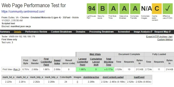

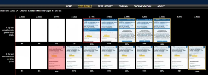

With the AMP addon I've been making you are not really giving up much of the "original look/branding" of the site. The non-AMP and AMP pages look very similar, the only major part where it is "noticeable" (if you would open and compare) is the logo position and navbar button. Otherwise everything else is almost identical
 For someone landing on your site from a search engine, it doesn't matter. If they start interacting with your site, they will use the real site anyway

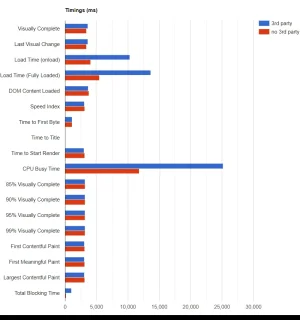

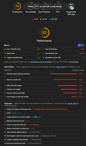

			And no matter what you do, AdSense and similar advertising networks are still going to be dragging down you page load speeds and there is little or nothing you can do about that except give up the income and stop using ad networks. Not many forum owners are going to do that and smaller and/or newer forums aren't often in a position to be able to sell and host their own ads.
Yes ads are always going to lower the score.

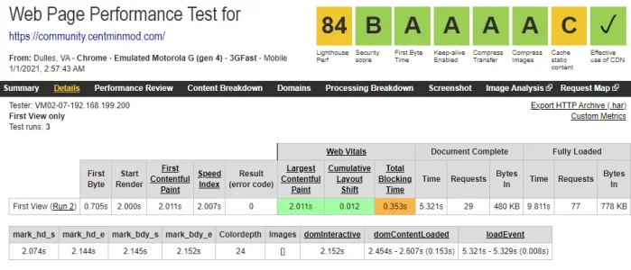

The Pagespeed scores are anyway just an indicator, so try to bring it up as high as possible (without ads) and then add the ads (if you want to monetize).
The added benefit with AMP is that the ads will also be AMP pages, and can't load megabytes of JS that will hog down the main thread.

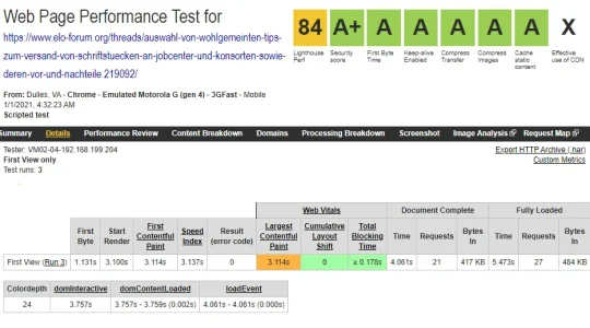

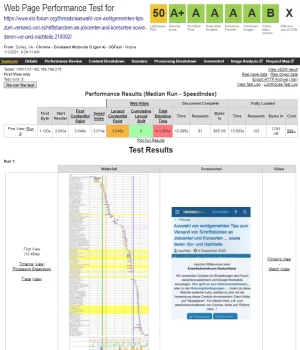

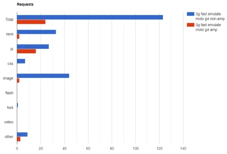

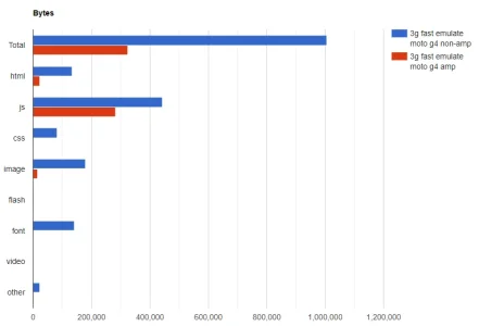

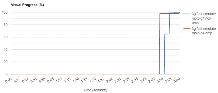

			Going from 1,500+ KB to under 800+ KB helps. Yes AMP can do the same for you too just you have less control over the process.

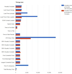

On my site with the AMP addon installed and ads enabled, it now loads 728kB of AMP JS, so that is extra JS trimming you could have.
Not to mention that the AMP JS is alo optimized to try and be lightweight, something that can't be guaranteed with non-AMP JS
Disabling ads, the loaded JS size is 543kB, and If I removed the analytics it would be a further 98kB saved
