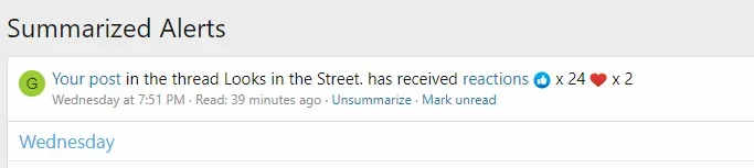

Seems to be a small bug with summarized reactions and pagination.
Came across a post that has reactions of 24 'likes' and 2 'loves', clicking on the reactions link shows 20 on page 1, but clicking on the link to page 2 reports an 'oops, we ran into some problems' error.
seems to be a link formatting problem.
the pagination uses this link:
...account/alert/?alert_id=xxxx&page=2
it should be
/account/alert/xxxxx/?page=2
