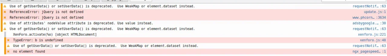

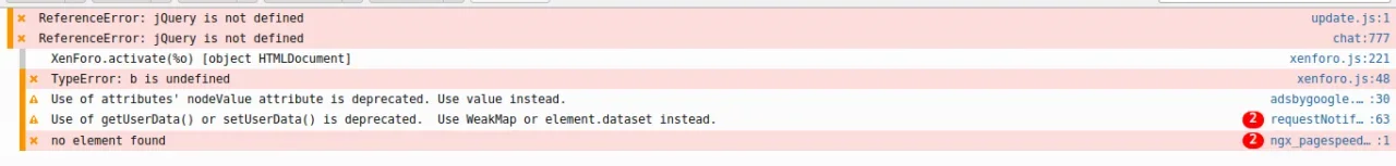

With this addon enabled, Taigachat stop working with this error on console:
Screenshot from 2014-08-19 21:08:58.webp Screenshot from 2014-08-19 21:09:20.webp
Again maybe because I have defer js addon.

With this addon enabled, Taigachat stop working with this error on console: ...
Do me a favor. In debug mode, go into the template modification for my add-on (it's called Bloodcinder_AlertCount_Script) and where you see the URI for the JavaScript change it from js/bloodcinder/alertcount/min/update.js to js/bloodcinder/alertcount/update.js to use the full version of the script instead of the minified. See if that fixes it. If not, try disabling the Defer add-on and see if everything plays nicely together. If either of those solutions fixes it, then I can work with it. If not, I'm not sure why the error messages would be occurring, because my add-on doesn't do anything to "undefine" jQuery, and it seems that TaigaChat is unable to find jQuery.

I just disabled Defer JS addon and it works fine now, so this is incompatible with Defer JS addon.
Okay. What I'll do later (today? depends on work) is install Defer JS on my own forum and try to get the add-on to be compatible with it. Then I'll attach an experimental update to this thread and let you try it out on yours and see if it also fixes the TaigaChat problem. If that works, I'll update the resource with the changes.
