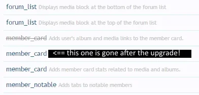

MG 1.1 After upgrading my custom template modification is gone!
imthebest
When I was on MG 1.1.0 I created a template modification in the template "member_card" (additional to the 2 that come as stock). I have just upgraded to 1.1.1 and noticed that my template modification is gone! IIRC, during an upgrade the system will overwrite the stock template modifications of the add-on however I'm not sure if it is also normal to have those extra template modifications deleted.

Any template modifications you create should be linked to your own custom add-on, not the existing add-on.
Otherwise they will be removed when upgrading.
You tagged your template modification as being part of the add-on. It is totally expected that it is removed when you upgraded the add-on. You can't modify parts of an add-on and expect it to persist an upgrade to the add-on. There's a very good reason why you can only do this in debug mode.
If you really want to do this via a template modification, don't apply it to an add-on (or create your own add-on to contain your changes).

Right. But, seriously, just edit the template directly. With the frequency we actually change the member card template I can't even envisage you'd ever be in a situation where it becomes outdated.
