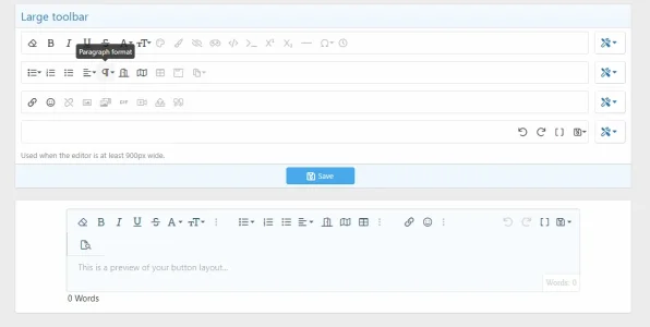

Additionally (and possibly related), for some reason the paragraph formatting bar (which appears on native Xenforo) will no longer show for any of us. It appears in the editor options, but not in the display or the actual editor.
Note how the "paragraph format" button does not appear anymore between "Alignment" and "tabs" in thee editor preview, despite being placed there in the toolbar settings
What version of XenForo are you using?
Are there any javascript errors on that page?
