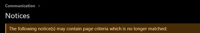

I noticed your add-on allows multiple template names to be added to the page criteria in Notices for Content template is and Content template is NOT. This is really helpful. I didn't know which add-on allowed this so I searched the phrase "The name of the template specified in the controller response. Multiple templates may be separated by commas."
However when I add multiple templates, it works, but the main Notices page shows this error. Is it possible the errror can be removed? Thanks
