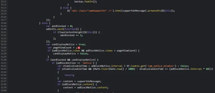

I've noticed that issue. Set a value for "AdBlock notice display after" admin option until I relaese a bug fix.

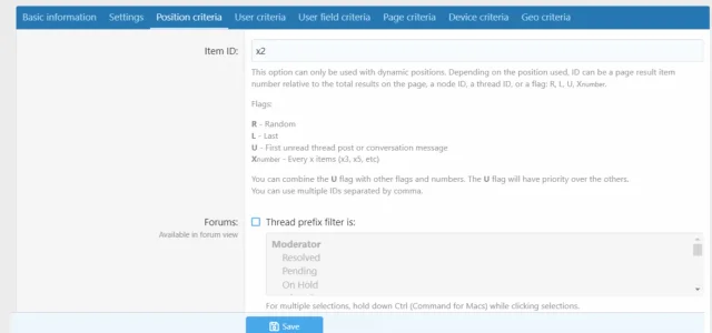

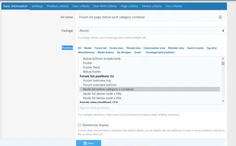

Hi, we are using the "Lite" version of Ad Manager. Some of the positions such as "Node list below category x container" are not working for us and we have no idea why, and we have set the "Item ID" correctly as well, as we did for other positions which has the 'x' variable. But yeah, certain positions just simply aren't working, and when we turn on the "Enable position visualization" option, not all positions show up visualized.
Any idea what's going on here? Are some just not configured properly by default?
We use UIX.2, but we did test on the XF Default style, and same issue.
Thanks.
What have you set there? It requires the actual ID of that category under you want the ads to display.
OK, I tried just using the Node IDs and that seems to have worked. Thanks.
I had thought that anytime a position mentions "X", that we would have to go "x1" or "x2", etc.
