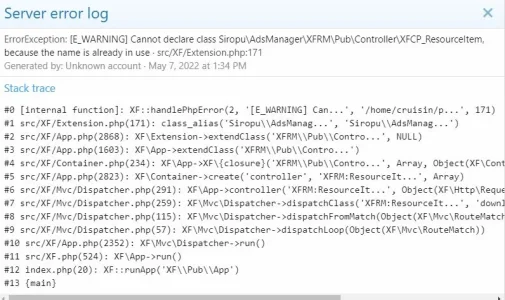

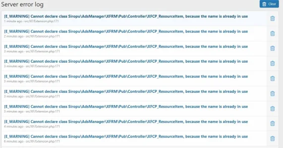

@Siropu, could you tag me when you put a out a fix for the current errors. I've had to completely disable Resource Manager until the issue is resolved.
