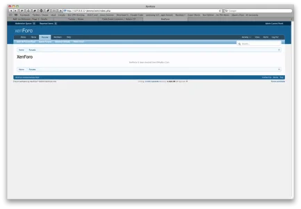

And... once I do some code clean up and make it its own add-on... See picture. I just tested it and...

I'm not sure what you have planned.
But I think people mostly want is for whichever Addon (which usually has it's own Tab) to be displayed when a user goes to www.site.com. People don't want the Forum tab highlighted ....
FYI, I do know there is a MOD which allows you to Highlight a certain tab when a certain page is displayed.
Jeremy
I'm not sure if I could modify the tab. I'll see what I can get done and all, but mostly, this works. I need to figure out how to get this to work if invalid input is placed in there.
