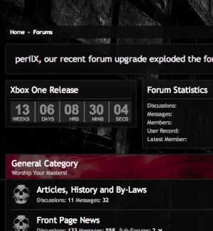

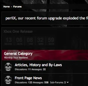

I've just updated XF to 1.2.1 and XenPorta to 1.5.9. The portal is working perfectly now, got my reroutes all set, just having issues with my forum index.
Previously, I had a left sidebar and right sidebar on this layout. Adding blocks to the "Top-Left" position gave me a left sidebar with my forum list in the center column. Now, adding anything in that block will put it above the forum list underneath a block of my background image (which is transparent). If I add something to the "Top-Right" position, it will show both above the forum index. Any ideas?
Relevant images attached.
Edit: It's actually adding the Top-Left position to the forum index box. So weird.
