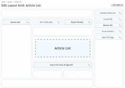

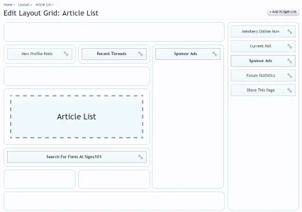

I'm looking to change the layout of the article page by moving the left-aligned sidebar to the right as seen in the screencaps:
From this:
To this:
I want the "Sponsor Ads" section aligned to the right.
Can someone please share how I could do such a thing with XenPorta 2
I'll appreciate all assistance. Thanks!
From this:
To this:
J.
Can anyone help with this please? @Jaxel
Thanks,
J.

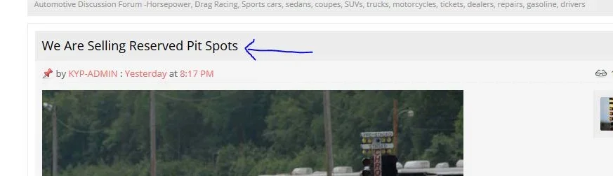

Hello, i am trying to figure out where and how to change the title text/link color? View attachment 146816
Everything is in style properties.
From this:
To this:
J.
The design of the blocks grid was designed as a "most use-case" solution. It has a design that could fit most people's preferred design. If you would like to change it, you would have to apply your own CSS rules to shift different sections around. Everyone always asks "can I do this?"... Yes, you can do whatever you want; if you're willing to write your own CSS rules and template edits.
LOL. I completely know it's doable. I've edited many parts of XP2, or rather XP2 widgets... Great script btw. I recommend it to all my clients and will be purchasing my own license soon.
I'm just asking if you could point me in the right direction or suggest a way right-off-hand -- since you're quite familiar with the code -- as to how to accomplish the sidebar edit that I need. I've tried adjusting the .css and it really had no effect that changed the sidebar layout and I'm not at all sure which part of the XP2 code I'd need to adjust.
Anyway - thanks for the consideration.
J.

It should be pretty simple... just edit the first 3 lines of EWRporta_Global.css and swap all the lefts for rights and vice-versa:
.leftContainer { float: left; margin-right: -{xen:calc '@porta2_leftwidth + 10'}px; width: 100%; }
.leftContent { margin-right: {xen:calc '@porta2_leftwidth + 10'}px; }
.leftSidebar { float: right; width: {xen:property porta2_leftwidth}px; }

Thanks for taking the time. I really appreciate it and will give it a try a bit later.
Hope you have a great Tuesday!
J.
BINGO! Code worked perfectly.
Thanks so much @Jaxel
J.
