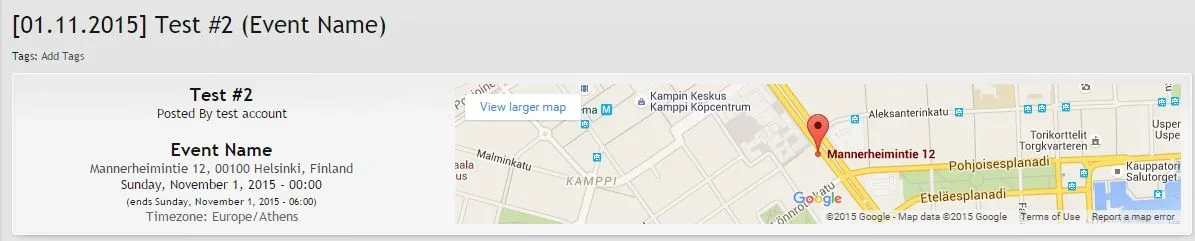

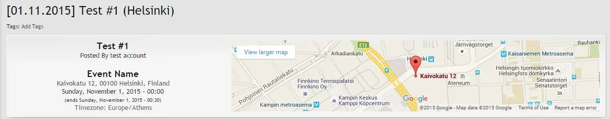

While doing additional testing I noticed some weird behavior that doesn't apply to all finnish addresses. For example when creating an event with address Vaakatie, Vantaa (or another example: Mannerheimintie, Helsinki), thread title location uses event name. What makes it weird is that some others addresses do work just fine, i.e.: Kaivokatu, Helsinki.
If I change thread location format to state, then it gets the correct city data for those problematic ones (...and in turn adds unnecessary data for others.)
I'm guessing this is soemthing to do with how the data is stored at google maps, but hopefully there is something that could be done to fix it.

All addresses are searched using Google Maps. It needs to be able to find a valid result.
Yes, but it does find a valid result at least when looking at the resulting map/address data via the frontend
Working one (Kaivokatu 12, Helsinki) :
(Kaivokatu 1, Helsinki doesn't work)
Nonworking one (Mannerheimintie 12, Helsinki) :
Unfortunately, its whatever Google gives us.

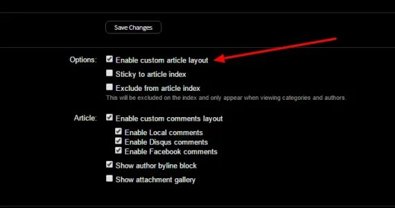

Ok i found it after digging. But this is a bit cumbersome. My steps to make it work is:
1. Create event together with making a thread about it.
2. Thread tools > promote to article.
3. Scroll down and remove the custom layout.
4. Save.
Why i didnt get it/find it is because that option is not there when creating a event.
Would it be possible to already have a disable checkbox for the custom layout (and if possible already unchecked) when creating the event itself? Currently i dont have this option. This is what i have:
It would also be awesome to delete both the topic and the event in one click instead of having to do both seperatly :)
