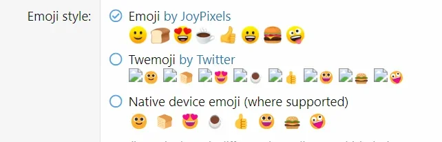

Hi,
Twemoji has stopped working due to MaxCDN going offline. I've tried testing it here on xenforo.com but I guess another option is being used?

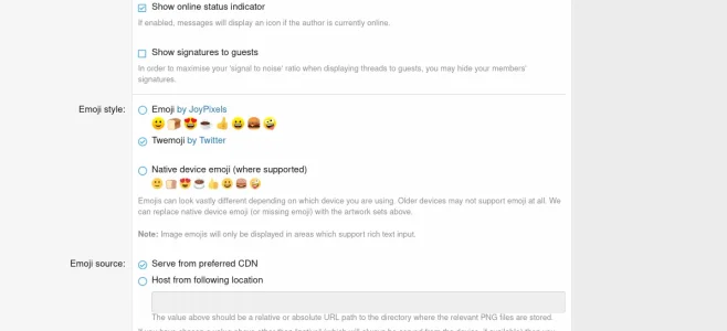

In ACP, the twemoji examples are also gone:
The following CDNs can be used as an alternative (though ACP will stay broken as MaxCDN is hardcoded there)

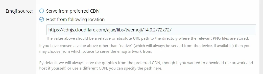

I changed maxcdn by cdnjs.cloudflare.com this in the file XF\Str\EmojiFormatter.php while waiting to have an official fix of XF, Otherwise, the quickest way is just to put the Cloudflare link in "Host from following location".
$config['path'] = $useCdn ? 'https://cdnjs.cloudflare.com/ajax/libs/twemoji/14.0.2/72x72/' : $config['path'];

There is no need to patch the file to change the MaxCDN URL (unless you care that the example emojis are displayed in ACP), just changing the option to supply a working CDN URL manually is enough.
