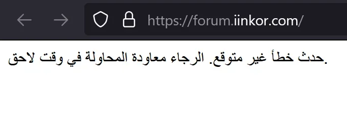

XF 2.2 the forum stopped working
i was adding certain addons and it told me that it had a problem then I clicked on the deleting files option the forum stopped working
Solution
i deactivated the addon from there and deleted the files still the same problem
so i deleted the whole addon from there then deleted the files and also still the same
though the addon does not exist, the files insist on remaining there and I can't delete them to keep the site working

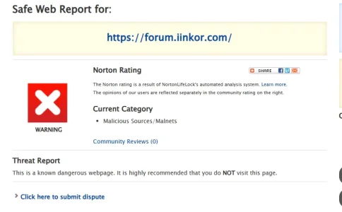

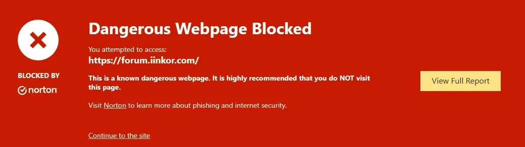

Perhaps because it is blocked?
