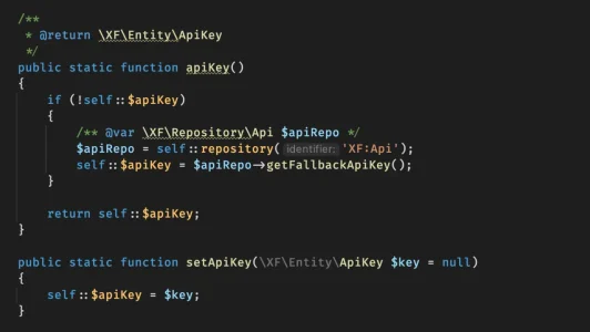

So I went to /src/XF.php and reverted block "@return \XF\Entity\ApiKey" from 2.2.2 version.
Lines "return self::$apiKey;"
And it started working again.

2.2.4 XF.php check with your hash of the file
return self::$apiBypassPermissions && self::apiKey()->is_super_user;
VS
2.2.2
Swapped back to the old code and fixed. Of course, it's my implementation, what else. Duh.

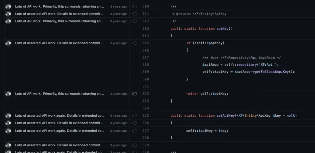

I can confirm categorically that whatever code you think belongs to XF 2.2.2 absolutely does not.
The only location that return self::$apiKey; appears in XF.php is within the apiKey function which hasn't been changed since we first implemented it in XF 2.1.0.

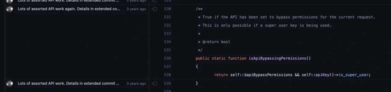

The code return self::$apiBypassPermissions && self::apiKey()->is_super_user; appears in XF.php in the isBypassingPermissions function and that function, also, has not been changed since we first implemented it in XF 2.1.0.
In other words, out of the code you have mentioned, every line of it is exactly as it has been since it was first written in XF 2.1.0.

XF 2.1.12:
PHP:
    public static function isApiBypassingPermissions()
XF 2.2.4:
PHP:
Enough said.

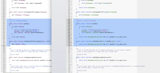

What are you talking about? Are you sure you are looking at the right block?
On the left is 2.2.2, right is 2.2.4.
I have got a copy from your server and since I'm here just to point at your mistake and not looking for any support tickets, because I have figured it out myself faster that you started your work day, I'm not going to reveal a license key just to get it banned by some pissed off dev. You take this report or you don't, it's up to you, but be more careful of what you roll out. Thanks.
XF 2.2.2:
XF 2.2.4:
You did not get the code you say is from 2.2.4 from us.
