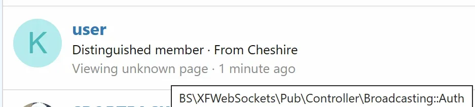

This addon stops the "Who's online" location working, as everyone gets set to: BS\XFWebSockets\Pub\Controller\Broadcasting::Auth

I'm talking about the members online page - https://xenforo.com/community/online/
With this addon enabled - everyone shows as "Viewing unknown page" with the path as above.
I'm guessing this is because after the page loads, the websocket is called which then changes their currently viewing location.
In any case, disabling websockets obviously fixes this.
