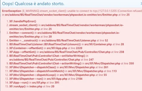

changing this now when I go to the forum root no more errors come out. But if I try to write error it comes out
.If you do not provide me with an error, I cannot help you.
1 if I try to write, the error mentioned above comes out
2 if I try to reach stroia chat the 404 page not found error is output
3 the chat in lock
help please

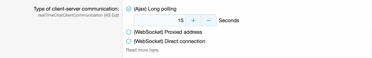

you can switch the type of communication to long polling. It does not require additional configuration.
It didn't require additional configuration on previous versions. Now it does. After the last patch I had the same error ("Failed to load resource: the server responded with a status of 404 (Not Found)"). And yes, the type of communication is long polling.
